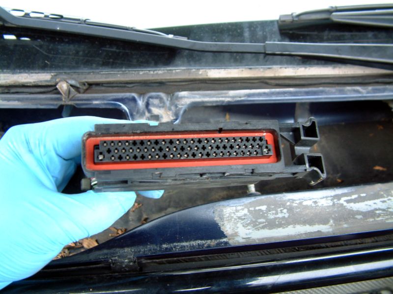

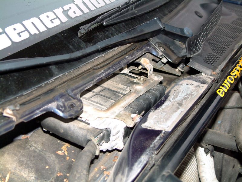

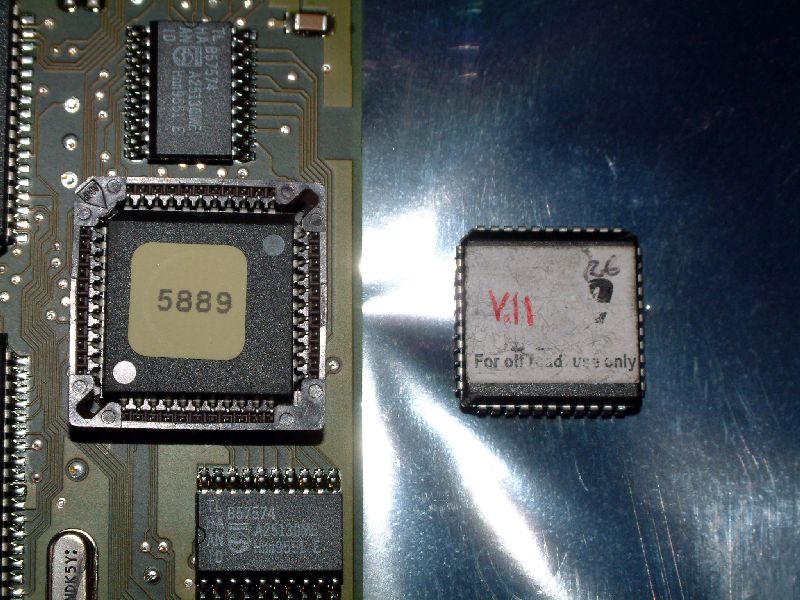

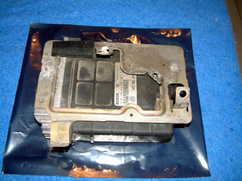

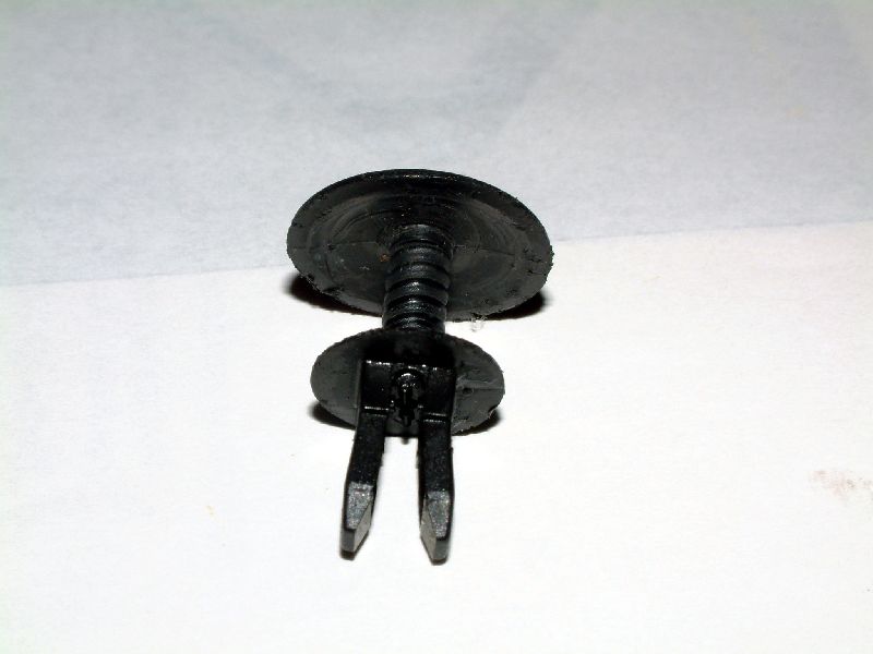

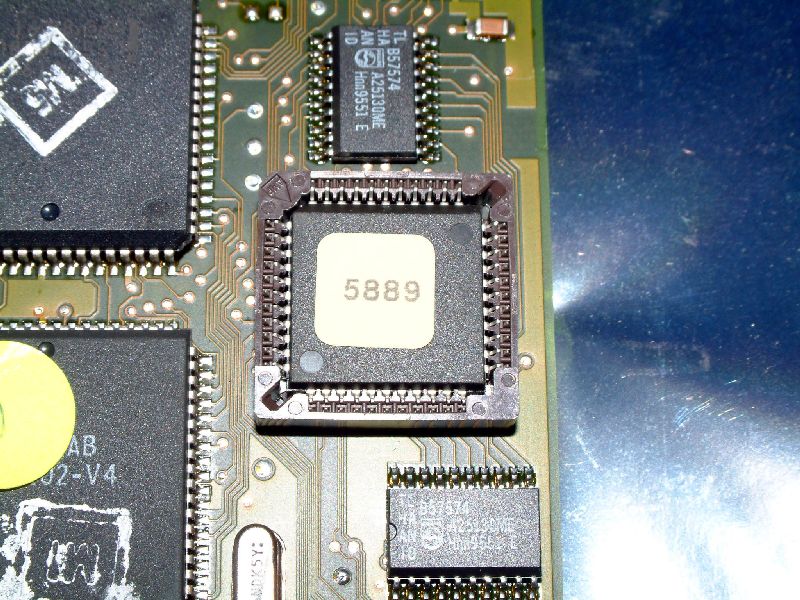

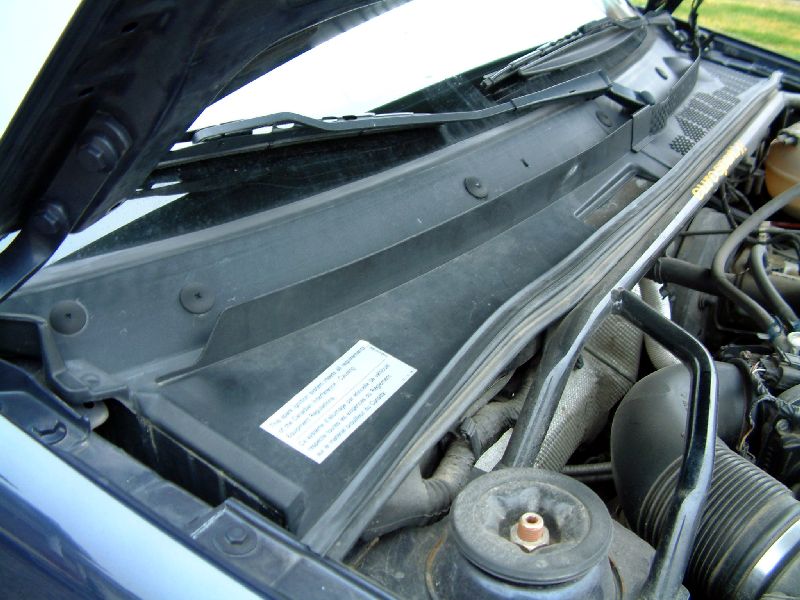

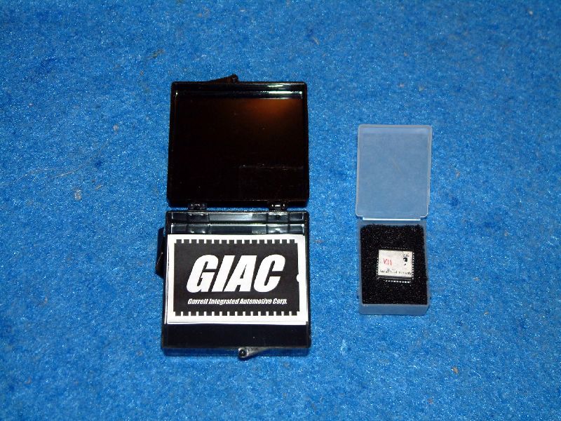

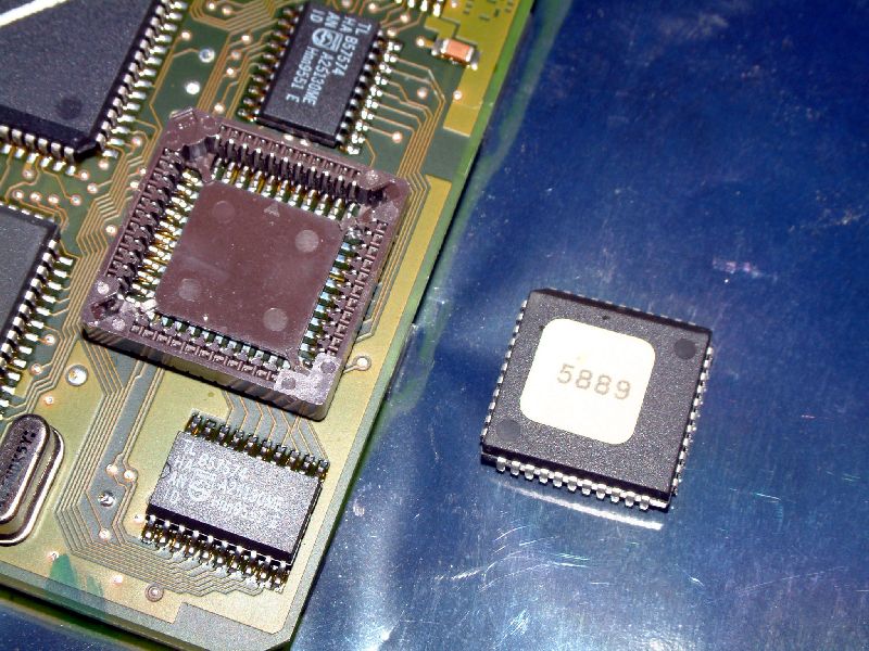

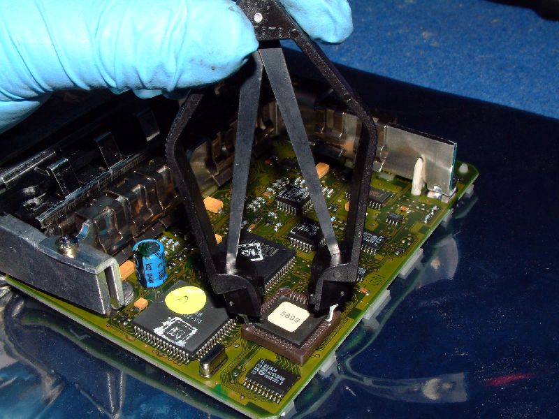

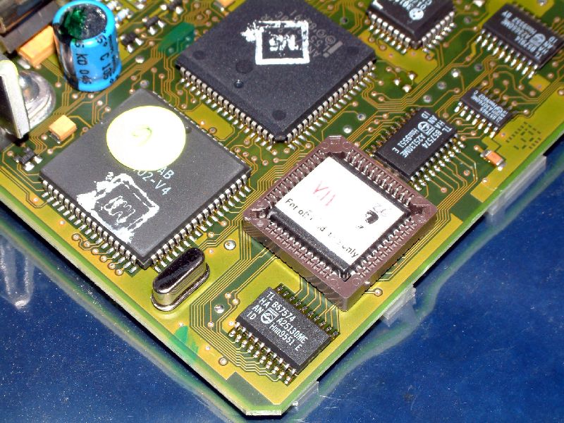

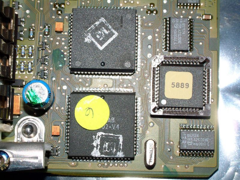

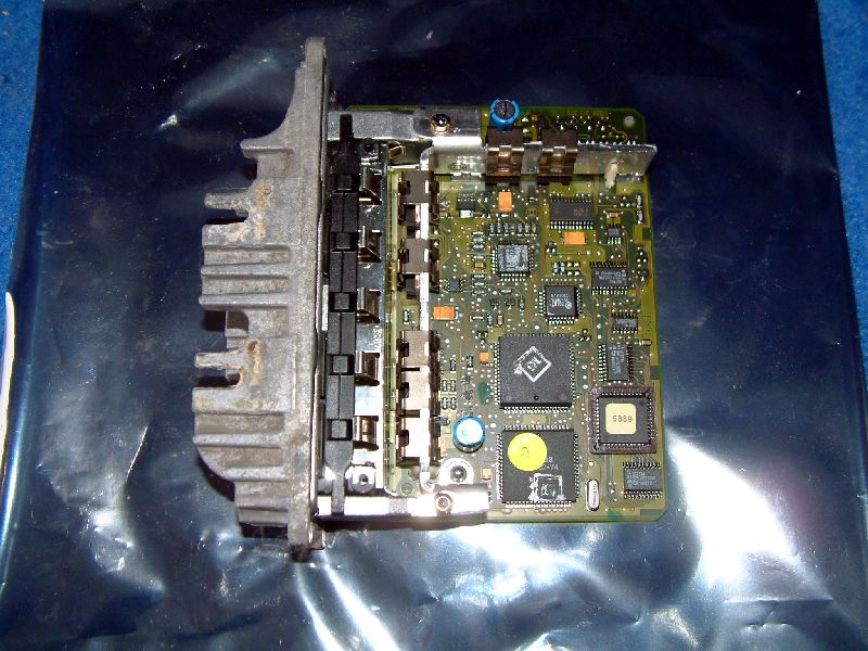

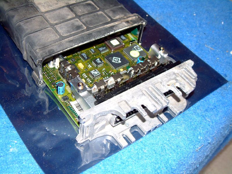

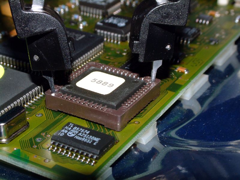

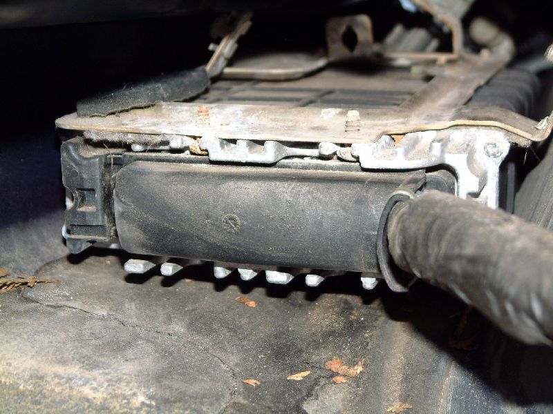

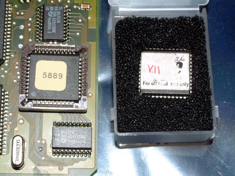

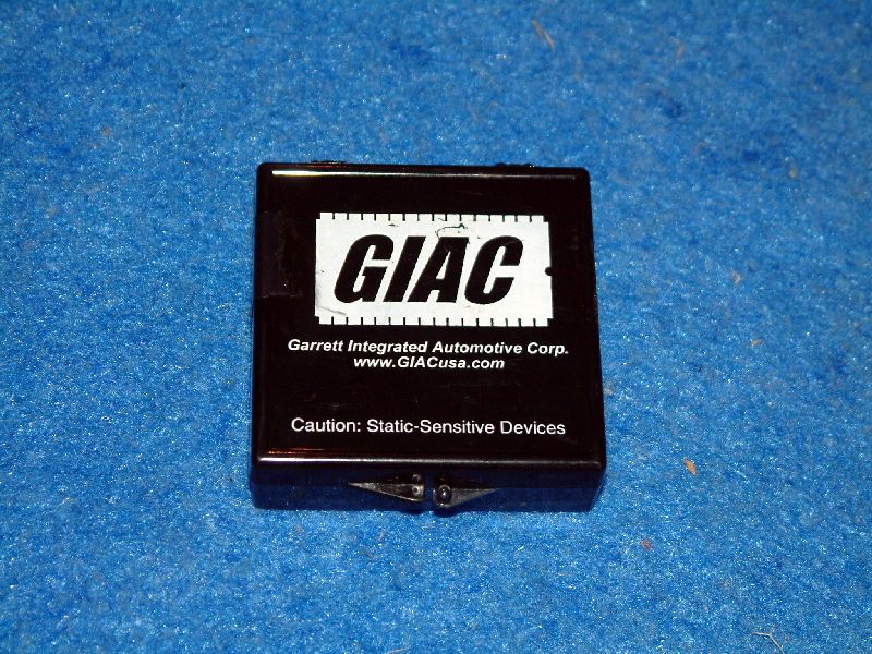

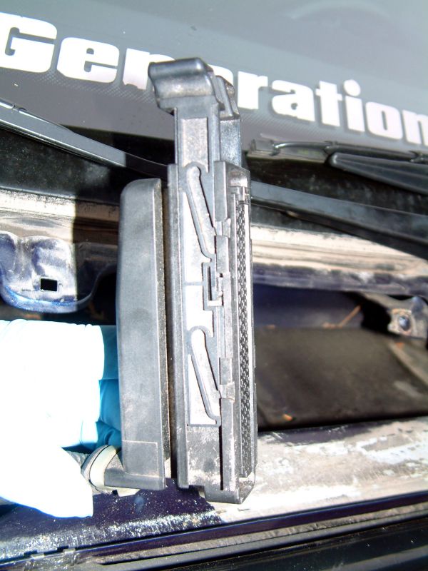

    Installing a GIAC chip in a MK3 is very easy. I picked one up for my old 1997 12V VR6. GIAC claims an increase of 7-10hp & 10-12 ft-lbs. It removes the speedlimiter as well as raises the redline.
    In total, it took me about 45 minutes to install the chip, but I was taking pictures at the same time. The toughest part was getting the damn rain tray cover off! Those damn plastic screws/grommets are a bitch!
    Outer chip case
    Outer and innner chip case
    Rain tray
    Stubborn ass plastic screw/grommet!
    ECU location
    ECU wiring harness
    ECU removed
    ECU disassembled
    ECU "board"
    Stock chip (indicated by the "5889" sticker)
    Stock chip (left) and GIAC chip (right) ***NOTICE THE HOW THE "NOTCH" ON THE TOP LEFT OF THE CHIP ALIGNS WITH THE "ARROW" ON THE SOCKET***
    Removing the stock chip with a "chip puller"
    Stock chip removed
    GIAC chip installed
    I honestly thought it was going to be much more difficult to do. The only "special tool" required was the chip puller. You can pick one up for about $6 at your local computer geek store

    How the hell did you those damn screws off???
    SoCalEuro Member Forum Supporter kooz's Avatar
    1,281
    Re: So look at what came in the mail today!!!!!
    I actually used a fork to gently pry the top of the grommet up, while unscrewing it. Once you remove one, you'll see how the bloody thing is designed and the rest should be much easier.
